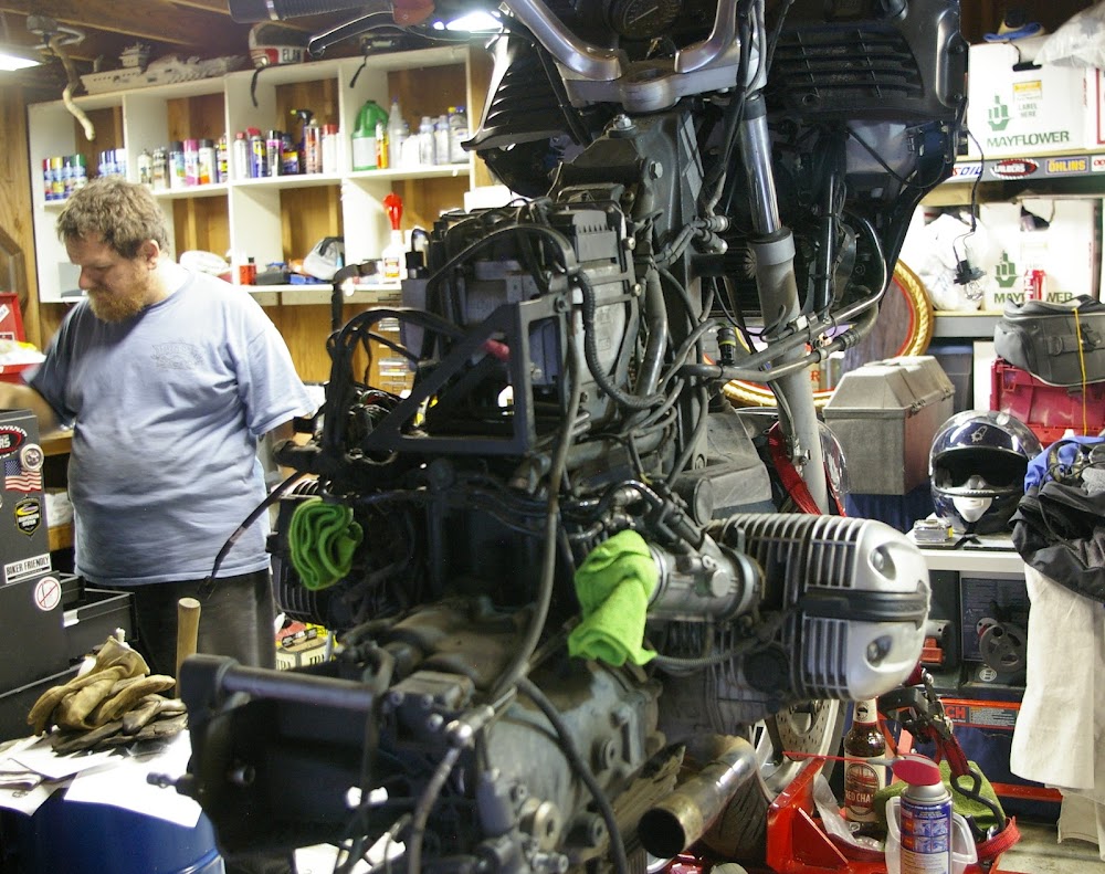

Today was demolition day, taking all the goodies off ( for use on the new RT ) and start dismantling ...

I have not the slightest idea what I'm doing here, as usual ...
Oh, yes, and a new battery, as well
Let the wrenching begin ...
On the lift
Everything is good ...

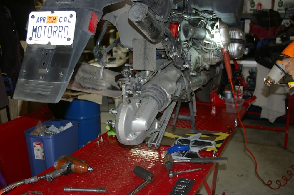

Rear wheel is off, starting to take of the final drive
with the help of a heat gun to loosen up the locetite
Seems to be in pretty good order, no shavings or other unwelcome particles

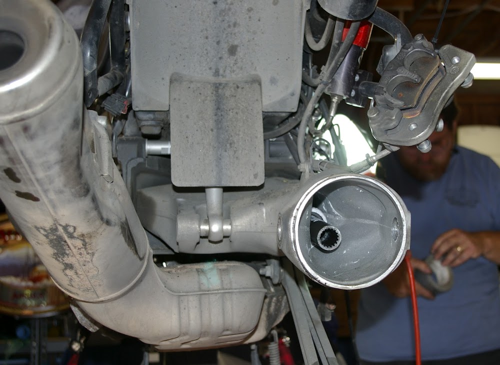

Rear end of the drive shaft
The exhaust was a bit more work, but with a lot of wiggeling and slight hammering, it came loose
The drive shaft, coming out of the transmission

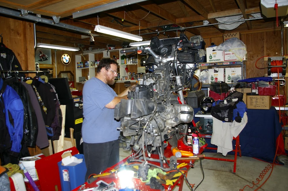

After taking of the fuse box, rear subframe, and tons of cable binders, almost done. The only thing that still has to go, is the transmission. Well, next week ...
The front still looks kinda OK
more next week ...

We may have been able to cut a few corners, but I would rather just get it all out in the open and make sure we do it all right. I have been told this is one of the big reasons the police are moving away from the RTs. Clutches are high mortality items with police work and a 12 hour job vs 2 hours at the most job on a Kawi or Harley is a big deal. I went through the screws the other day ... stunned so few fasteners hold the back of that bike together.
