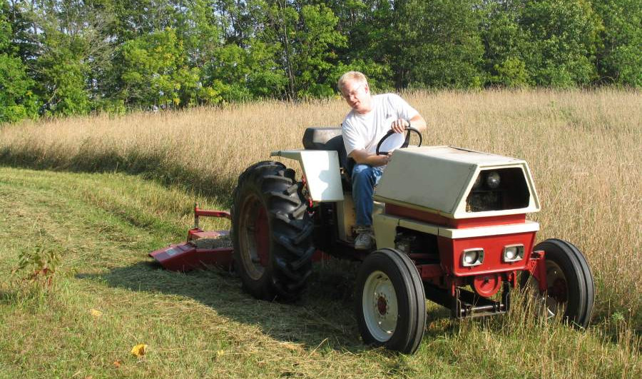

1968 Bolens experimental one-off tractor: only one in existence, Designed by Roger Mayhew in 1967: Still in operation, owned by James Zarnoch  Corfu, NY
Several years after buying the Bolens prototype, I decided that I would redesign and build the tractor the way I thought it should have been built. The first thing I did was to increase the tire size. I changed the rear from an 11.2 to a 12.4x24 and the front to a 5.50x16. This did not leave much room to get on the tractor, so I lengthened the wheelbase. This tractor had the Vickers hydrostatic transmission, and I decided that it should have a gear transmission. The tractor had a Bolens GK 2 speed on the rear axle housing, so all I needed was a 3 speed to make it a 6-speed transmission. I installed a Borg Warner 3 speed with reverse transmission. Then I acquired a Renault R688 engine of about 30 HP. I had all the clutch parts from the Bolens GK tractor and everything fit together. The water-cooled engine required a radiator, and I bought a IH radiator. However, that did not fit under the stylized angled hood. I made new hood side panels and rebuilt the fiberglass grille. I removed the hydraulic diverter valve and replaced it with a 2-spool valve.

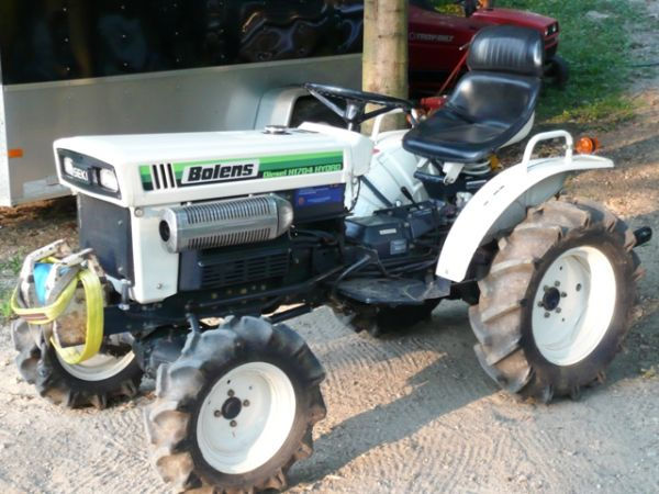

In October 1978, I went back to Japan by myself. I went through Tokyo and to Matsuyama.  The main tractor factory was in Matsuyama. Matsuyama is located on the island of Shoko. Matsuyama had about 600,000 people and I was the only westerner in the entire town. I was there for a week and a half writing the specifications for the tractors that we were going to buy from Iseki. I did all the engineering negotiations by myself. I did get to see the castle in town and did not get to the country side. That island farming was mainly mandarin oranges. FMC had sold orange juice squeezers on this island.
The Iseki main office was in Tokyo. When I visited the main office, I stayed in the New Otani Hotel. That was the fanciest hotel in town. The hotel had an 8 acre Japanese garden inside the hotel. When I was staying at the New Otani, the premier of China was staying there at the same time. The Chinese took a whole floor and the security was very tight. The Iseki people could not get into the hotel without knowing my room number.
There were protest demonstrations against the Chinese going on across the street from the hotel. Many of the Americans in the hotel were watching the demonstrations from the hotel. I decided that I had lots of time on the Saturday and went for a walk. As I was walking down the sidewalk in front of the hotel, about 20 Japanese riot squad police came up the sidewalk towards me. They simply walked around me and proceeded towards the demonstrators. I went on to the downtown section of Tokyo.
Bolens-Iseki 4wd tractor

36-hp diesel Iseki Tractor we used on our farm for many years

The one-off 1968 Bolens experimental we called the 'Red Tractor' as kids and used daily on our farm was sold to Bolens collector James Zarnoch of Corfu, NY. After my dad passed, my brother went to Wisconsin and brought the Bolens QT16 garden tractor he designed in 1968 with the loader and weight box on the rear back to California, where it continues to operate today.
1968 Bolens experimental tractor - one in existence
